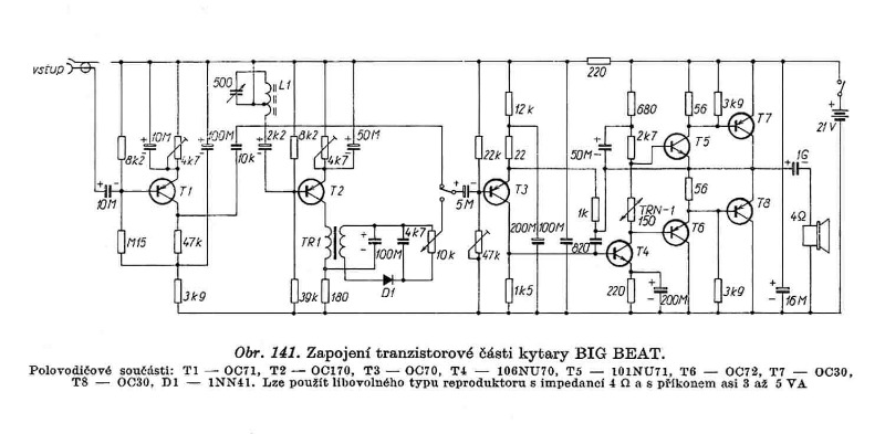

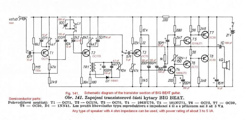

Комментарий к схеме (в переводе с чешского на английский), выложенный вместе с ней 8 декабря 2020 на [link] :
This circuit diagram of the electronic part of the Jolana Big Beat guitar is from page 168 of the book Amateur construction of electric musical instruments by Bohuslav Hanuš, published by SNTL-Práce, Prague 1967. [Amatérská stavba elektrických hudebních nástrojů od Bohuslava Hanuše, vydalo SNTL-Práce, Praha 1967.]
The description from pages 168 and 169, in square brackets is my comment:
"Somewhat different kind amplifiers of the same power [4 to 5W] are shown in Fig. 141. The indicated connection will be of interest to the owner of the BIG BEAT electrophonic guitar — it is precisely the connection of this product. More experienced readers will recognize at first glance that transistor T1 is connected as a preamplifier. Transistor T2 is connected in the circuit of a small audio unit, which is intended for listening to a local radio station. The input of transistor T3 can be switched to either guitar preamplifier T1 or local radio station reception (transistor T2).
In the event that one of the readers would like to make a small transistor amplifier for a guitar according to the connection in Fig. 141, he can omit the entire circuit of the transistor T2 without any modifications (provided that he renounces the possibility of listening to the local radio station).
Amplifiers according to the connection in Fig. 140 [Simple Standart amplifier for home use, 4 to 5W, tube] and Fig. 141 are obviously not suitable for use when playing in public. They have little power and their technical parameters are not outstanding.”

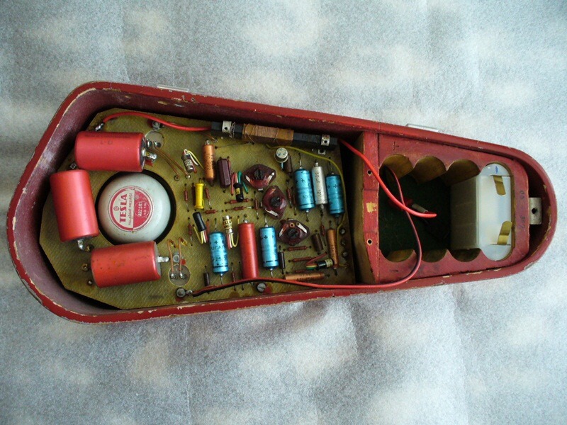

The same amplifier with radio section was used in the Jolana T6 portable case apparatus. If you look at the circuit board of both devices at [link] , you will see the exact same circuit board shape and component layout inside the Jolana T6 combo as in the Big Beat guitar. So the scheme of the Jolana Big Beat and the Jolana T6 are the same (except for minor differences such as connection points, number of speakers, etc.).
If anyone is interested in the diagram of the tube amplifier from Fig. 140, please write, I will take a picture with the image capture device and add it here.

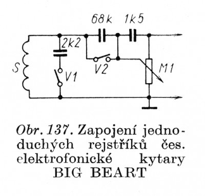

И далее там же (пост от 20.09.2021):
"Электрические регистры заводской гитары BIG BEAT, состоящей из трех конденсаторов, можно найти на рис. 137. В четырех комбинациях мы можем выбирать разные тембры звука переключателями V1 и V2 (выходную громкость можно регулировать потенциометром М1). ). Параллельно датчику S через переключатель V1 подключен конденсатор 2к2, образующий известный фильтр нижних частот. Расположение двух других конденсаторов выбрано не очень удачно, поскольку при разомкнутом ключе V1 манипуляции с переключателем V2 малоэффективны."

23.08.2024, 21:40
Что касается УНЧ, то как бы норм. Несколько заковыристо (по мне) исполнен АМ-приемник прямого усиления. Я попроще в детстве их паял. А что скажут наши признанные электронщики?
24.08.2024, 04:12
Сообщений: 2562
Приемник - сверх регенератор. Сейчас, по крайней мере, в Москве- только атмосферные помехи.
24.08.2024, 12:55
Alexstar, что значит старая школа! И хорошо, что приемник там не рефлексный. (-:
[ Редактирование 24.08.2024, 21:05 ]

Что за трансформатор на схеме может кто то подсказать?
26.08.2024, 11:10
Сообщений: 4205
Илья130790 Цитата ...
Трансформатор на схеме относится к радиотракту,на нем выполнена схема детектора и согласования выходного сопротивления
Сам усилитель мощности и предусилитель датчика, без трансформаторные.

26.08.2024, 18:17
Товарищи элекронщики, а тип приемника? Если сверхрегенератор, как писал Alexstar, то схема как-то ... непохожа (на мой взгляд).
Сейчас, кроме помех, в этом диапазоне можно поймать только по ночам заграницу. Если паять что-то "по мотивам", то лучше ФМ модуль (да простят меня аутентисты) или просто оставить одну "гитарную" часть.

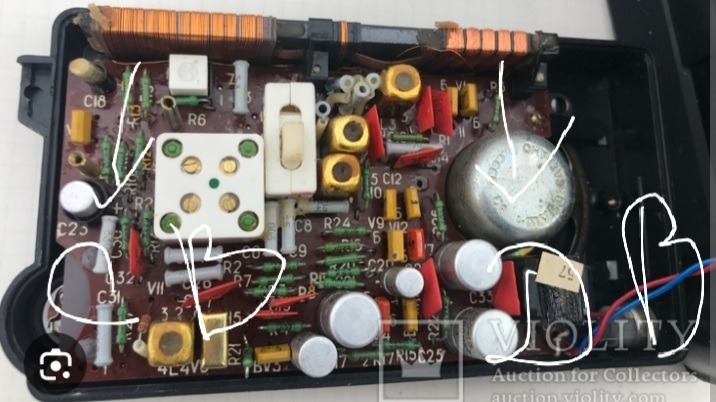

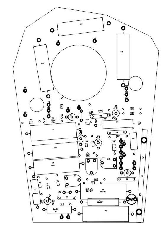

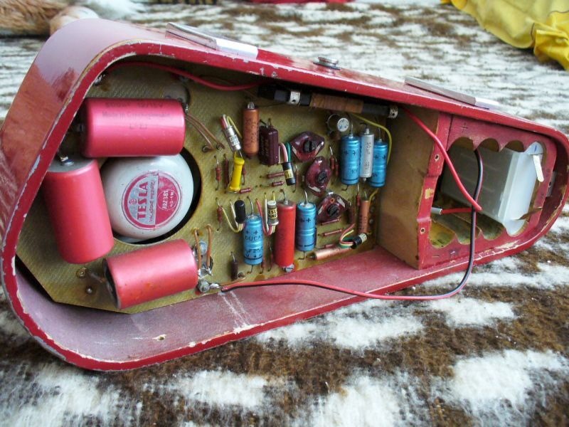

26.08.2024, 18:28
Где на плате этот TR1 ? С обратной стороны?

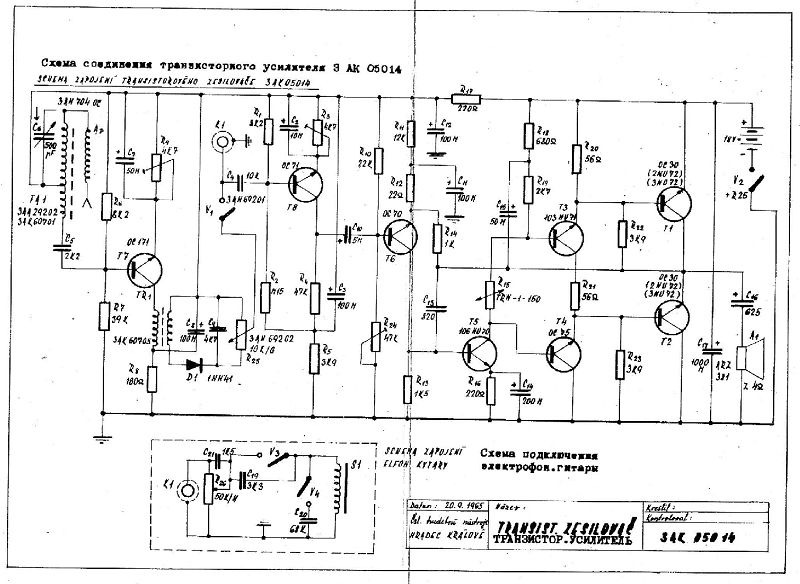

26.08.2024, 20:42
Нашлась схема с комментариями на русском, а также фото с фрагментом платы с обратной стороны:

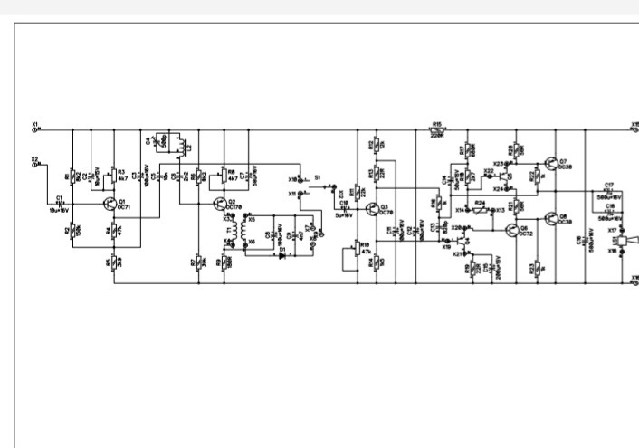

Илья130790
27.08.2024, 09:15
ID пользователя #3183
Зарегистрирован: 16.04.2012, 10:57
Местонахождение: Poland
Сообщений: 355
Как то так
27.08.2024, 09:59
Сообщений: 4205
Приёмник 1-V-1
трансформатор нужен только для того , чтобы поднять напряжение для работы диодного детектора.
если опираться на подобную схему, [link]
то трансформатор 1 к 3 на ферритовом колечке.
27.08.2024, 17:16
Пардон за флуд.
Для 1-V-1 надо сигнал после детектора пустить опять на базу транзистора (по сути рефлексная схема), как в схеме на приведенной Baza ссылке. Нет?
27.08.2024, 17:24
А транс, да, на феррите, скорее всего. От абонентского громкоговорителя не пойдет. Только где он на фото монтажной платы?
29.08.2024, 20:58
Сообщений: 4205
Транс скорее всего на другой стороне платы

Поправил схему может кто то глянуть все ли верно?

Вот

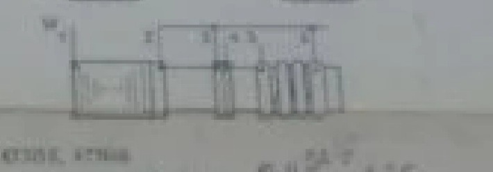

Все собрал по схеме уселок работает, вопрос теперь стал с приемником, антенну буду использовать от нейва 304, вопрос как соеденить катушки чтобы оставить только св диапазон и выкинуть дв?
Илья130790
02.12.2024, 11:00
Сообщений: 355
Вот еще для наглядности, я правильно понимаю что слевп катушка СВ, справа катушка ДВ(можно выбросить), по середине катушка связи?
